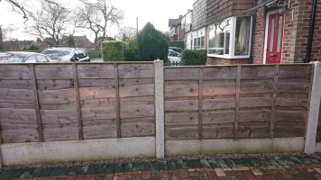

Before, dipped beam:
[Edited to say - that is with Philips 150%, not standard H4]

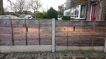

After:
(Note scientifically placed calibration markings :slow rofl:)

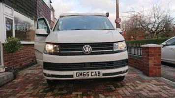

Unfortunately I deleted the picture of 1 white DRL with 1 OEM (yellow) DRL, but they are significantly whiter, a much nicer look.
The Philips H7s also looked a bit better, difficult to tell in the light, but seemed to make a difference.
Put it all back together (used the Transporter HQ video, also helps to have removed bumper once before) and only one piece left over! I had a bulb error and I think one DRL was not in correctly, so I fiddled with it, and it came on, but the holder stalk thing came away. But it started raining and got dark, so that is sitting in the van!

Difficult to say, I did put in one side uprated H7 and standard H7 the other, even though it was daylight and quite sunny there was a clear difference. Bear in mind that I had Philips 150% H4 bulbs in.
I think you would notice a big difference between standard H4 and H7, but if you have them on the bench with easy access, then for £25 quid dipped / £50 for both, why wouldn't you? And you have a set of spares!
