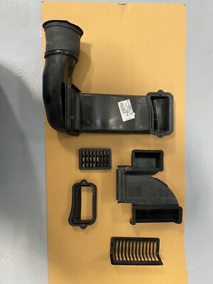

Not sure if this has been posted, but if you're looking to buy the Planar heater, this company can also supply the ducting, vents and a template for the B pillar holes for an extra £165
alternatively, Insurefit can supply just the ducting and vents for £170 + £15 postage

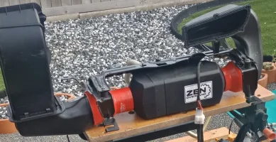

Don't know if that would work, at least without some fiddling with the settings on the new controller/board to get it to run correctly as I believe the VW supplied unit is neither a 2kW or 5kW which is the usual choice for chinese replacements.
If you can get just the cradle then a chinese heater will fit, 5kW version with no problem, a 2kW needs some spacers and some suitably sized hoses to connect up to the VW ductwwork. This is a 2kW heater in the VW cradle.

I can't remember how much I paid for my cradle and ductwork, it wasn't cheap, like £250 iirc . Got it from Cotswold T5 off eBay.
Be aware that the duct outlet off the California will not fit a regular Transporter, you need a different bit to connect the outlet on the B pillar to the grille on the cover.
See earlier in this thread for part numbers and differences
