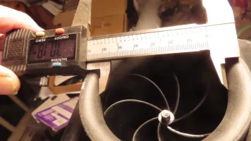

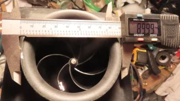

Okay, to explain what's going on: The original VW heater outlet is 90mm (intake is 75mm btw).
The D2, St2000, and 2kw Planar/aliexpress heater outlet is 60mm.
To connect the 2kw heater to the original b-pillar ducting you can do the following:
2kw heater -> 60mm flexible metal duct (usually supplied with the heater) -> 60/90mm adapter -> rubber part of the VW duct.
The Webasto adapter part number: 9011011 / 1320760 / 9011011C / 1320760A
