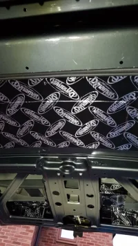

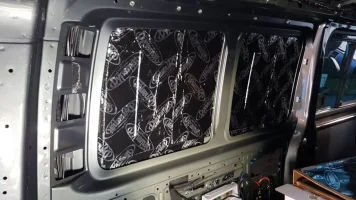

Really good use of what is essentially 'dead' space!
Probably saved you a few quid in sound deadening foam as well :D
