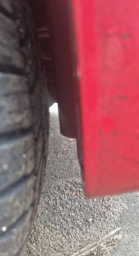

I have 265/60/18 cf1100 on mine and they just rub on a hard full lock just on the very outside of the mud flaps it's so fine you can only see it when they are muddy but thinking might put 235/60 on the front and move the others to the rear

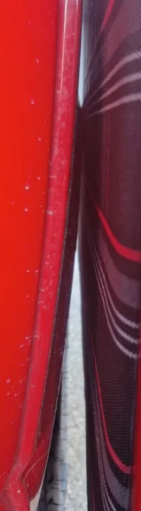

235/65/17 on ET35 rims..... I have more of an issue with the wheel arch than the tyre, but there is only about 15mm between the tyre and the door.
She's tight! :rofl: and that's after she'd done a few thousand miles all around Europe! o_O:rofl:
And yes, filthy too!
