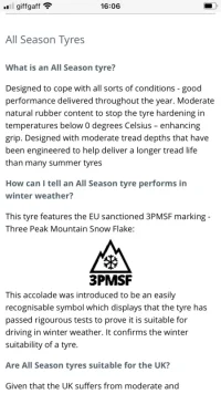

They have 3pmsn designation so they are certified for winter use, the BFG KO2 don't have this rating.
We have run nearly every BFG/GG/Cooper AT tyres on our Double cabs over the years. This is our new favourite AT tyre, much better road manners than most; full winter rating/all-season; last along time; and on a 4wd tons of off roads grip.
102 load rating so fine for Vels (not T32's)
I’m confused now....according to the BFG website the KO2s DO in fact have the 3PMSF accreditation...
