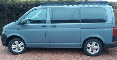

That’s really tall and yet they don’t look it at all, must be the wheels that mess with my eyes.
To be honest, I think it's too much tyre but it came complete and I'm just happy it fits (just), so my plan now is to run them until they need changing and go with a 235/65 r17 which I think will be about right.
Also planning on a 35mm lift at some point too.
