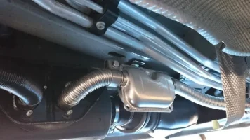

I've got a Eiesbacher (not sure how you spell it!), it's brilliant and if using the van in spring / Autumn imo an absolute must. I very nearly did not have one fitted but would of been big mistake. I use the van when the nights are getting chilly and makes a massive difference to the enjoyment. I've not used a fan heater in the van so cannot comment. I have nice wheels but would of had the heater over the wheels now! :-)
I set the temp and goto bed!
Nick
We went away a few weeks back and it did stay on all night, not too noisy either as ours is under the van and not under the seat. There is a option of fan only so in summer it'll blow some air around the van, but only circulate as they don't pull air in from outside. Mine pulls it from the drivers footstep thing in the door.

Hi there, I have bought Eberspächer D2 and struggling to find a suitable location for an under floor mounting. I can’t use under the drivers seat as the leisure battery is there and space is limited, i’d Like the exit temp on the passenger side due to the kitchen layout.
The passenger seat swivels so no access there, I was thinking running the cabin heating tube in via the column on the passenger side.
Do any one have ideas or pictures of a possible location.
