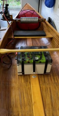

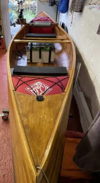

I thought I’d post a few photos of my Valence canoe power pack. It’s been well tested now and I’m very happy with the 10 year old battery performance. Thanks to @Dellmassive
It’s shoe horned into an IP67 enclosure, I don’t think I could have found one with a tighter fit.
All quick mating IP67 connections.
It’s got the standard Victron BMV 712 bluetooth monitor with smart shunt, I monitor the battery on the Victron app while on the water, no battery protect.
I’ve fitted an audible water detector with the sensor at the bottom of the box, PP9 powered.
As it’s a sealed unit I was concerned about a possible pressure build up in case of water ingress causing gassing, I considered a NRV vent but that’s just another route in for water if I have a capsize. I opted for a very sensitive pressure / vacuum gauge from a CPAP ventilator machine, it’s amazing what you can find online.
At full speed I’m pulling approx 37-39A for hours on end, the battery temperature reaches approx 36 degrees.
Obviously if water gets into the battery one of us is leaving the canoe in a hurry, the battery securing strap is on quick release but I also have the option to jump.
Having a motor allows for lazy days, going against wind, tide and current and going further. Obviously there’s always a risk of a power failure and the need to paddle so if I’m in open water there’s a degree of caution involved.
I’ve no plans to use it in the van so far as my leisure system is adequate but I’m considering using it with an inverter for the house as we have regular power cuts.
It will probably keep my oil fired boiler going for a considerable time.

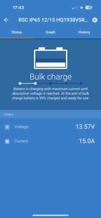

I have some problems. I've got the Valence U27-12XP 138ah/1.7kwh battery, and I've got a Victron IP22 charger attached.
Previously it has charged the battery OK, I don't know what has changed but when I power the charger on now in Li ion mode it goes up to showing 16v but 0.0 A. The battery voltage read by the bluetooth Victron monitor still shows the voltage the same.
Any ideas please?
If its not pushing any amps when its showing its giving 16v then does that mean its not charging as the V/A go together?
I went over to Victron as it seemed like a them problem and stuff.
Searching for 16v I came across this thread that suggested that the SmartSense battery monitor had a temperature compensation issue and hence going up to that voltage. I removed the SBS from the VE network and it dropped back down to showing 14.6v and 0A on Absorbtion. I managed to coax it into Bulk Charge mode, but its now at 14.52v and 0 A, but the SBS is showing 13.39v.
I am reluctant to leave it unattended overnight though... I'll try it again tomorrow and may get on the phone to the charger supplier. There are also many on the Victron forum that say it is a problem with the latest firmware of the charger. The supplier may be the only person locally that I know of that can rule out a fault I with the unit I have.
just delete the VE-smart network in the app. ( you need to delete and not just leave - as it will remember the network for next time )
the charger will run stand alone and sort out your problem.
the disconnect and reboot your smart battery monitor.
then try to remake a new VE-Smart network.
you don't NEED the smart battery sensor for the charger to run, - but it does add temp data,
but again that only important if your charging in sub zero temps.
Yes, I disconnected the VE network last night. I made sure all of the connections were severed in the application, I also uninstalled and reinstall the application, making sure any data files were wiped.
Whether it is plugged in or not, it’s not showing any amps only volts.
[a few hours later]
So. I confirmed with a multimeter that all the fuses were correct, and had the battery box fuse pulled and left out for a bit (whilst I found my multimeter) and then put back in. I did the same with the victron charger (coffee time) and when I put the fuses all back in I also did a reset on the actual charger itself.
When I plugged it all back in it started charging and took the battery up to 14.2v (yaay!) But the bluetooth wasn't working anymore. It got to 20% and then back to 1% and repeated a few times until it failed. More google fu
So I removed all of the pairings and removed the app again, reinstalled and it all works.
The charger charges, the app does its thing and the battery is now being charged at... Oh. Its back to 14.5v absorption charge and 0 amps. But the battery sense is now showing 14.40v on power and unplugging the charger it goes down to 14.39v It was charging at 2amps. I'll give it about 20 minutes for the battery to settle as its already dropping voltage and it needs to stabilise doesn't it.
I've not used the battery yet at an event and I've not done any testing with how long the battery lasts... But its something moving forwards. Hopefully the charger continues to work. I'll not return it just yet then....
Thanks for listen to me ramble here... I guess this is something more for a 'Victron Charger' thread than the valence battery, but. I'm here now ;)
