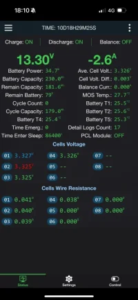

One final question… hopefully. I gave this a test today and it charged my Roamer battery to 13.3v and then stopped charging (alternator). Though the Roamer bms is only saying it’s 79% charged. Any ideas why it stopped? I gather I need to tweak something. It’s on the default lithium settings.
Could be the Roamer cutting out the charge...
Ie cell over voltage etc.
Or could be the Renogy hitting a Max bulk charged time limit. Etc etc.
You will need to I check and screenshot the Roamer app and Renogy app to tell what's going on.
Pretty sure it’s the Renogy cutting as the red alternator light goes out. Quite possibly due to the voltage dropping from there? Dunno why though since it was working fine up to that point. Maybe an hour-90mins. I don’t have a screenshot of the Renogy but will post one.

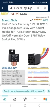

What's the volts,watts,amps of your solar panels?
So we know what size/rating switch you need.
Most people just fit a mini rotary isolator, or a quick disconnect plug.
But you can use a relay or other as you need.... Just the switch ratings need to be sufficient.
Not purchased yet. Just thinking if it can be done. Yes I was planning on a rotary isolator or RCD. But my charger and batteries are under the rib bed plus the solar wires will run down from the rear of my pop top. I don't obviously want to run my solar cables in a loop so the switch is near the cab. Happy to run a switch via a relay to the main cut off switch/breaker but I've no idea what to even look for. It's over my limited knowledge.
What size solar panels?
Got a few picks?
Example,
100w 6A
200w 12A
300w 18A
With a solar voltage of 18 - 36v
So I'd look for a relay that can switch 20A 36v.
This example can switch ,80A and 75v max.
So should be well suited for switching a panel on or off...
Thanks Del. I'm hoping for 200w min preferably 300w of solar depending on sizes etc. Using a remote or wired relay is the way forward.

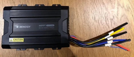

Thanks for the write-up on the Renogy 50A @Dellmassive, I thought the same about it being a Redarc copy when my 40A DCDC + MPPT arrived today. It's a Renogy RBC40D1S.

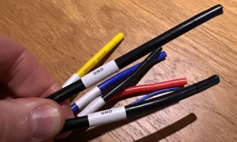

I'm a bit concerned that this model has three (black) GND wires fixed to the unit, which seems unnecessary if you're grounding to the chassis, rather than a negative back to the starter battery, leisure battery and solar. Any idea why this has been done this way? Should I connect all to a negative bus bar? Or just one? It's a bit strange combined with my limited understanding.
Interestingly this unit prioritizes SB over solar, which I think is an improvement over previous units that would switch to solar even if that meant slower charging than SB.
