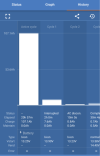

Ah, this may explain it...
Looks like the temp data from the BMV712 is being shared via the VE SMART local BT network I setup.
Screenshot_20240610_114831.jpgScreenshot_20240610_114751.jpgScreenshot_20240610_114735.jpgScreenshot_20240610_114820.jpg
Ahh ok, that makes sense. I think!
Interesting that you can have a VE smart network set up running alongside a Cerbo GX.
Yes, yes we'll cool.
VE Smart share s data between victron kit locally over BT.
At the same time I have the Cerbo GX connected to the same kit via VE Direct.... That gets you the data on the VRM platform.
In an ideal world all the local kit would share data over local BT including the cerbo.... But for some reason it doesn't. So you need the ve direct cable link as well.
Even thought the GX can use the BT Ruvvi temp sensors....
Here's hoping for a future update.

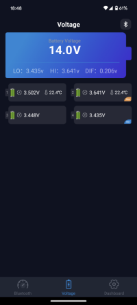

The Fogstar app is no longer displaying the correct SOC on our 105ah battery. It reads 100% even though the fridge has been on all day and it hasn’t been charged. Also it’s not showing a discharge. I have deleted the app and the data, and downloaded the current app version. Does anyone have a solution? Thanks. Nick
The BMS can't read draws under 1a, do you have a shunt or know what the fridge draws?
Or is the BMS in the app not showing any discharge at all, even over 1a?
Thanks for replying. We don’t have a shunt. It has always shown when the battery is discharging before when the fridge and lights are running. It draws more than 1a. The BMS isn’t showing any discharge.
Run the battery dead flat to 0% and it shuts off.
Then fully recharge the battery to 100% to reset the battery BMS.
Post some screenshot of the app page and details page.

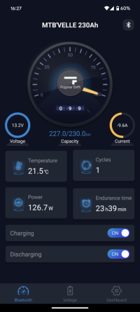

Well, received my Renogy 2000w inverter today, this is running my 55" OLED TV off it...
Might still take a while to do a couple of cycles!
I think I need to run it down to zero to allow the BMS to calibrate, right?
Depends why you are doing it.
If you're aiming to carry on forming the cells then gentle cycles is the aim, so I'd not run them flat.
I'd get a couple of gentle cycles in based on the BMS state now then push it.
