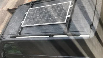

Im waiting for a pop top so decided I didnt want to stick an expensive panel on to the metal roof only to throw away when the pop top is fitted. So a 160W PU rigid panel attached to the OEM bars. Easy to put on for camping and remove when home.

Hi Skyliner. Im looking at mounting my rigid panel like this. Did you make the brackets or is this something that can be purchased?
