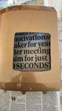

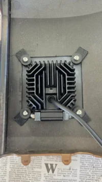

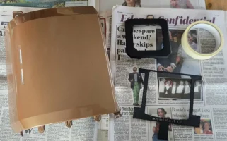

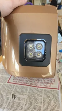

I thought I would get these installed on the Friday afternoon thinking they would be a quick and easy instal due to the few videos I have watched on YouTube....
Although it turns out if you have AirCon there is more work involved as the front bumper has to be removed! So bare this in mind if you have aircon. Its not too difficult but it does take longer and is more of a pain in the arse:

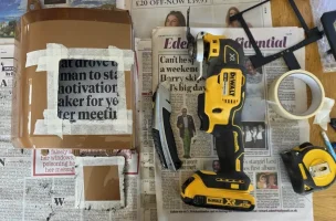

It started off quite simple with the adapters in place, marking out where needs to be cut and cutting through the grill:

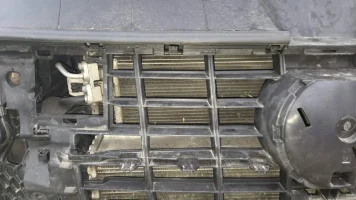

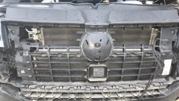

It turns out there is a second grill behind the first grill! It was at this point that I re-read the small print on the installation instructions and noticed that the air con models need the instructions to be downloaded from the internet and that there were further steps. 😖
I cut the passenger side out first and then removed the bumper to remove the air con pipe cover from the driver side:
Once all sections were cut I then tidied up the cuts, installed the lights into the bumper grill and re-installed the grill and began on the wiring:

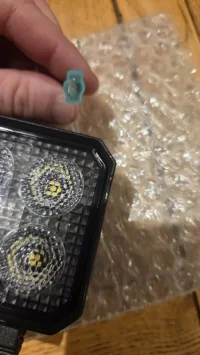

Frustratingly when tightening up the 8th bolt the lug literally just snapped off with barely any effort, clearly another printing defect issue in the strength of this final lug. I explained this in the email too and said that if they provided the address I would send them back.

Meanwhile, here are some pictures of the panel cutting and practice installation of the kit...

The broken off lug:
