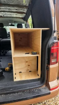

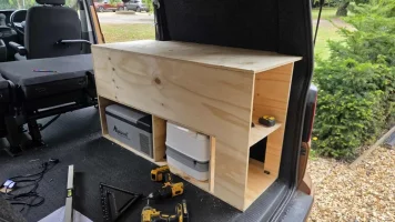

Whilst the van was back at mine and waiting to be finished off I set to work on designing the bed system.
As I need the van for everyday use, ferrying the kids around, trips out, solo camping, diving etc my layout isn't really the same as everyone else's. I also suffer from a medical condition that means a toilet is required on any camping trip.
List of requirements:
- Doesn't take up too much of the boot space
- Can be removed if required
- Sleeps one person
- Fridge and Toilet can be accessed from inside without opening the boot door
- Fits behind the rear seats
- Doesn't block the area where the middle seat sits (I'm changing layout to 1+1+1 rather than 2+1)
- Has storage for all my crap (stove, jump starter pack, fire pit mesh, fold up chair etc etc)
This is my first rough mock up that is no-where near complete yet:
The fridge and toilet will be on runners so they slide out into the van.
The small space next to the toilet will hopefully house a water heating unit like the Complex Nano 3 or similar.
The storage space will be on runners that will extend out of the van under the tailgate so there is an outside cooking area. (This will also be accessible from the top so anything can be removed with the tailgate shut.
I plan on also having a slide out section similar to the 'Outback Conversions' that slides over the rear seats to extend the bed.
I also have a 24L Wheel Arch Water tank that will fit behind the unit so need access to that.
After this first mock up was made I've now worked out where I can make some more suitable changes to dimensions and with the second mockup I'll install the runners and make some mock up drawers to see how it will all fit together.
Once the second mock up is done I'll look at getting this made in black Hex ply.

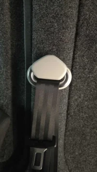

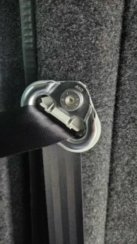

Next was to replace a little annoying thing that I didn't notice with the van when I purchased it:
(It had a bulk head in and I just didn't see it).
I ordered part number:
1J0-858-189-C-Y20
Which I thought was the right one, but when it arrived and I took the broken one off they were clearly different:
The actual part number required was:
1JO-857-731-C
Lesson learnt! Always take the old part off and check the number rather than relying on google!
Unfortunately because I didn't get back to VW within 15 days they would not exchange it. Fortunately, the only difference was the depth of the plastic at the back and this was easily shortened with a hacksaw.
I believe the one I ordered was for the B Pillar driver/passenger seat and not the C Pillar passenger seats.
After using the hacksaw and shortening it, it was easily installed:
Another little job ticked off the list.

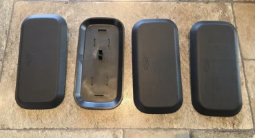

The next purchases were from Van-X:
- Glove Box cover
- Rubber inserts for the doors and glove box
View attachment 300244 View attachment 300245
The rubber inserts slip in nicely and are a great fit:
Before:
After:
(Sorry for the poor focused picture)
I am really happy with these. They stop the rattles and the scratches.

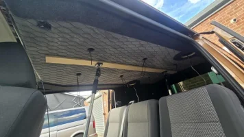

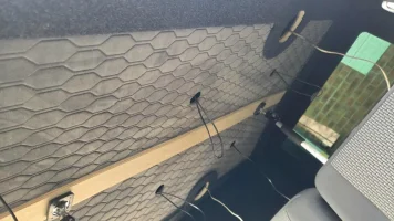

I only appear to have one picture of the ceiling, I really must take some more pictures!
The outer Halo changes colour and you can either have it as a solid colour or have it changing colour on its own, with the ability to change the speed and the brightness.
There are 6 spots in total. I decided to have these wired up differently to the average 'normal' person. The front two are over the top of the middle row of seats and due to having the children I opted to have these wired into the door opening. So these turn on and off with the doors and also the light switch on the centre panel above. The remaining four are on a dimmer switch in the rear. This is currently on a loose wire until I put my units in and know exactly where I want it.

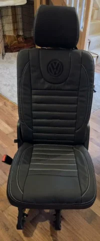

For the seats, I sourced these from Van Leisure UK on eBay who are based coventry way. These weren't cheap! It cost my £1,000 and I had to give them my old 2+1 split! But its the setup I wanted, so needs must and all that!
Whilst the seats were/are in great condition the service was a little frustrating. We arranged the date and time (9am) a couple of days before but when I arrived after the two hour journey there was no-one to be seen. Granted I arrived a little early but by 9.45 there still was no movement and my phone calls were going through to voicemail! Eventually my calls were answered and I was told 15 minters but still had to wait over 30 minutes for someone to arrive! But soon the seats were swapped over in the pouring rain. On the flip side I am happy with the quality of the seats and I would use them again... just next time I would be checking and ringing the afternoon before to remind them.
With the new seats in place (I stupidly don't have any pictures of these on my phone) it was time to order some seat covers. I would love to have them re-trimmed eventually but for now its covers. These were ordered from Leather Inn Ltd for £290 for the 1+1, 1+1+1 setup:
The installation of these is a little annoying and the arm rest covers they sent don't fit but for the price I can't really grumble.

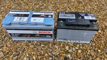

I had noticed that the van was starting to have issues with the battery so I thought I might as well swap it out before I go to find its completely dead one morning I'm running late.
After some research on here I decided to upgrade to a Bosch S5 A13 95ah. I purchased this from Tayna, delivered for £167.76
Fortunately I had already read on here that the new battery would need coding in. I still can't get my head around this though, who knew that even swapping a battery out now would require coding in this modern world!!
The new battery is brilliant. The van is a lot happier with this!

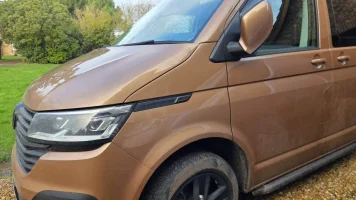

I've recently been having a think about my van and how I want it to look. Up until now I've been concentrating on the inside and whilst there is still a LONG way to go on the inside I wanted to make some changes to the outside.
I have no idea why I have gone down this route because previously I've never been a fan... (although probably because my mate has started down this path with his T6 and I really like it in the flesh) but I've decided to go down the Swamper style route. It won't be a full traditional Swamper but it will have a little subtle hint of it.
My first changes were to replace the indicators and purchase some swamper style vents from THQ:
The indicators were quickly installed:
Before:
After:
(Ignore how dirty the van currently is)
I should have gone for smoked the first time round!

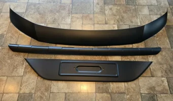

Items from VanStyle:
- Full width Black ABS Bonnet Protector
- Black ABS Rear Bumper Protector
- Black ABS Rear Number Plate Holder
I know I said I wouldn't use VanStyle again earlier in this thread but I thought I would give them one last shot. Other than their dispatch time not being great they did get them sent out after a little prodding and they are all in good condition. (I bought the items from THQ and VanX before VanStyle and they both delivered their items before VanStyle even managed to dispatch their items)

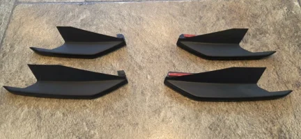

Items from VanX:
- Kombi Seat Base Caps
- Front Grill side Fins
- Door Card Arm Rests
I know these aren't 'Swamper Style', but whilst I was on a buying binge I ordered these too. :whistle:

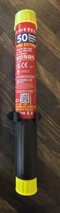

- The first was a fire extinguisher. Due to space, size and lack of destroying the van when using it I opted for a Fire Safety Stick:
I think I'll end up picking up a second one once I have the furniture sorted in the back so that I have one in the cab and one in the rear.
It was £69 which isn't cheap but its small, compact, doesn't need servicing and lasts 15 years before needing replacing.
