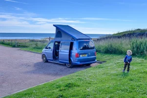

Thanks @DaveyB , got a few odds and ends to square away and then can start using it. Got a long weekend booked off on 7th July so that will likely be first trip away. Need to finish the gas and the propex heater and also get it reclassified so that using the rear seat is legal but that will all be done before the 7th
