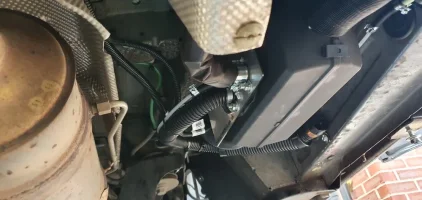

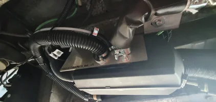

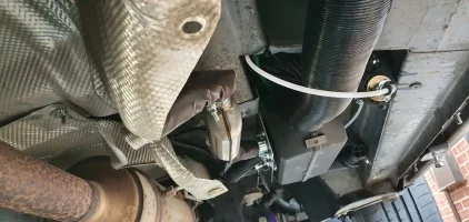

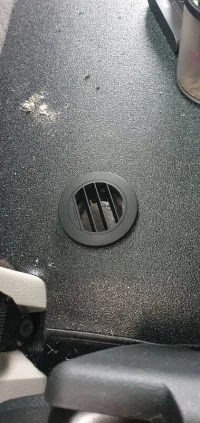

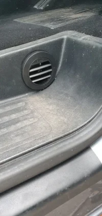

Another job ticked off today. I fitted a planar heater. Easy enough DIY job using the videos on their website. Not tested yet. Cables all ready to run from underneath the drivers seat. Eberspacher vents finish the job nicely on the inside.

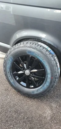

I've decided I'm going a different way with the van style today. I don't like how low it is and fancy going for the lifted swamper style. If anyone wants a brand new set of SV coilovers and wheels let me know.

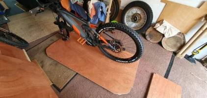

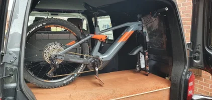

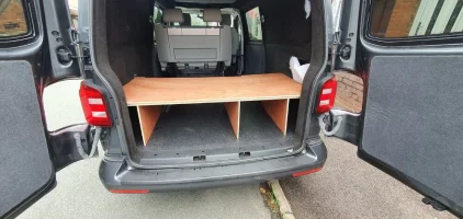

I've been working on the rear bike area. Starting with the bike shelf, bed shelf and supports. It's going to be a little more complicated than I first envisaged but it will be bang on when completed.
If you have the cali rails can't you just buy the metal wheel anchors or bar? Something like the 40 Winks Bike Anchor?
I get what you are saying but not what I want. I want to be able to have a functioning camper with the bikes inside. You couldn't have the bikes inside with the bed down. This way I have a waterproof bike area that can be completely separate to the cabin. If the bikes went in with the seat forward the dirt would get over my units. Not ideal.
The bikes are going across the width of the van. There is a drawing i made on the first post.
Sorry I now understand, slide in sideways over the top of the wheel arch. I'm sure I've seen a couple of LWB's with a garage at the rear. Some nice bulkhead options.

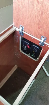

Bike garage box is coming on. Near completion. Side panels and bulkhead to be made next, ready for altroing, carpet lining and UPOL raptoring. Winter wheel/swamper setup wheels collected from refurb today. Fitting next week and raising coilovers. Epic winter setup if I may say so myself.

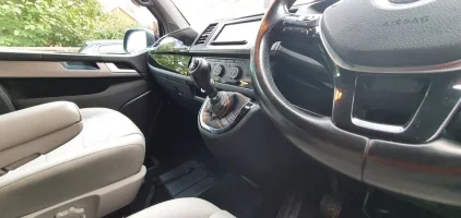

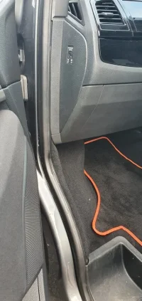

Can you advise what buzzweld product you used on the lower dash? Was it their plastics in one - PIO product? Also, do you have a good photo of the contrast between the lower and upper now that you have done it?
Excellent progress on your van! It’s looking good!
Thanks. It's getting there.
It was PIO, standard black. I can get you a photo shortly showing the colour match. I am very impressed with the match. There is a slight difference but nothing immediately noticable.
Nice one, it was black I was keen on too. Im looking to add caravelle door cards so thinking black would tie them in better
When I get the picture I'll get it with the upper dash and the door cards. Biggest improvement in the cab was getting rid of all the crappy grey/beige
