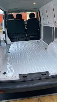

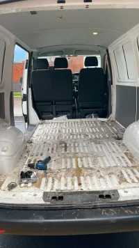

Stage 1 - The Strip Out
First I stripped all the van out getting rid of all the old ply lining and bulk head and then gave it a proper deep clean inside, feel this is the first step everyone makes when it comes to a van conversion.
Now I realised I never actually stated what the end goal of this van was/is. I am wanting to build a mountain bike camper van, something which can sleep two people (although snug) and hold 2 bikes so it can be used on long weekends away, bike race weekends and trips to the alps.

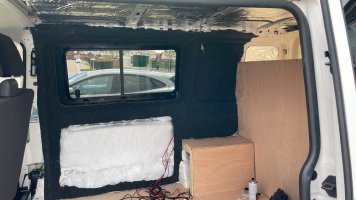

Stage 2 - Insulation
Next up was the insulation for the van. I layered this one going sound deadening, thermo liner and then plastic bottle insulation. All the parts I used are listed below.
Sound Deadening - Dodo Matt Deadn
Thermo Liner - Dodo Matt Thermo Liner
Insulation - Diall Plastic Bottle Insulation

Stage 4 - Windows and Carpet
Now for the scary part, cutting holes in the side of the van to fit some windows. Terrifying but surprisingly easy to do. I have gone for two slider windows, one in each side so it all looks symmetrical on the outside and lets in as much light as possible.
After the windows were all put up, all the walls in the living section were carpeted, possibly the worst job I have done on the van so far, but I think it came out ok for a carpeting virgin, just don't look too closely haha.
All the carpet was from Harrisons Trim Supplies in Anthracite colour.
