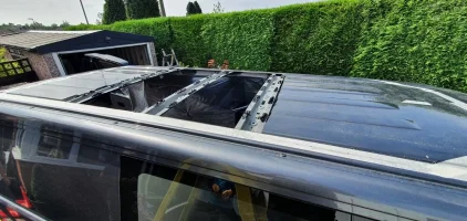

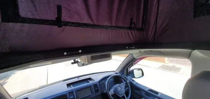

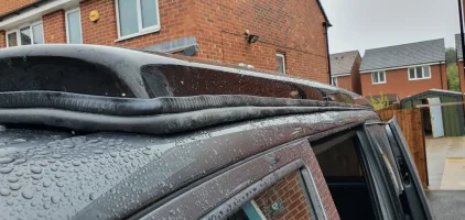

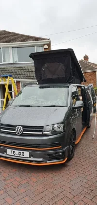

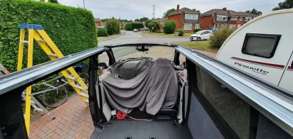

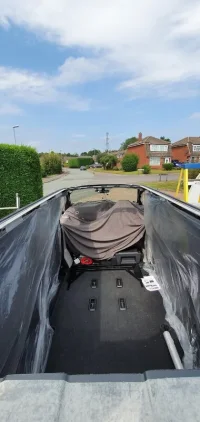

Big update. I collected my Pop Top from Denby Campervans in Leek on Friday. The weather held out and we managed to fit the roof on Saturday and I sealed it on Sunday. It wasn't easy and it isn't finished yet. Edges of the roof need shaping to the body and the front spoiler needs fitting. These will be done this week. Interior trim and elevating bed are still to do but less of a priority,
On the whole it was a success. Not easy, as expected, but it's on and seems to be watertight. The hardest job is getting the canvas fitted correctly and not being clumsy with a drill into the canvas.
The mechanical work was easier than the tent part. I did make a couple of mistakes and the gaps around the front edge aren't the best but the gaps have been filled with silicon and I'm going to fit an extra seal on the roof at the front where the tent meets the body, purely for aesthetics so you don't see a huge amount of silicon. The roof ribs are difficult to get around. I should have pre-formed it to the roof ribs before fitting. Other than that the roof is solid, waterproof and I'm happy with it.
Denby Campervans have been very helpful and their roof kit is very good quality. Instructions aren't perfect but if you are attempting this kind of job you should have the technical knowledge to work around the issues. The main thing is the dimensions were correct and with a little bit of adjustment the roof sits square.

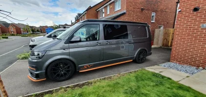

Fitted the front spoiler today. I hate glue... I'll leave it at that.
Now it's time to tidy everything up and make a proper job of it inside and out. (Roof needs shaping to the contours of the roofline and excess glue removed)

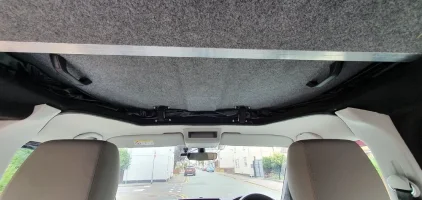

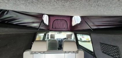

Elevating bed is now in and fitted. All that's left on the roof is to carpet line and tidy up the sealer on the outside edge.
A few more bits ordered. Leisure battery came today and the rest of the loom comes tomorrow from Rayne automotive. Planar Diesel heater with modem ordered and arrives tomorrow.
I've started getting materials and designing the rear bike area and bulkhead in the cabin. Looks like I'll be making a double skinned bulkhead. 1 side carpeted with a recess for a folding shelf that will complete the california bed and on the other side another piece of ply which is going to be covered in either Altro or LVT. This wall covering will follow down onto the base of the shelf for the bikes and then again on the front panel of the box the shelf sits upon. If I get it right it should look really smart.

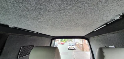

I'm finally back to a tidy looking T6. I've finished carpet lining, not perfect but not bad for an amateur.
