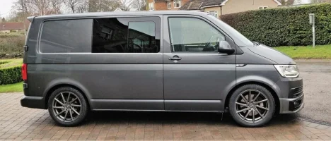

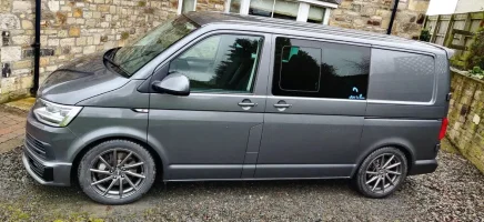

Hi, I recently put T311Rs on our van. I've got 9.0 ET35 front, 9.5 ET40 rear with 265/40/20s all the way round. Van is lowered 40mm and in that config I get no rubbing.
Have added few photos so you can see what they look like. I think the rear setup is spot on but I wish the fronts were tucked under the arch a bit more. With ET35 the tyre is just outside the arch as you can just see in the photos. I think ET 40 on the front would have looked better as it would pull the wheel under the arch a bit more, but don't know if that would cause rubbing
View attachment 26758View attachment 26759 View attachment 26760 View attachment 26761
