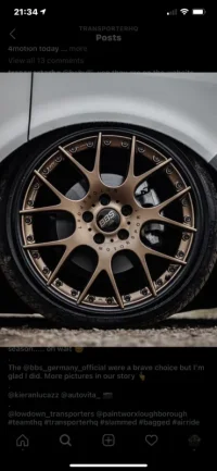

Hi what are these? Look lovely
What are these called look greatView attachment 31156

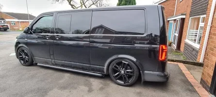

I didn’t want to put 245/40 19.. you know what the load rating police are like! There would be all sorts of crying involved. I run a 235/40 on mine. I’ve had the van weighed twice and well within weight limits.As said by @Jayjmac above, though i'm not sure i'd get 30mm spacers on mine. These are running 245/40/19 with 15mm spacers on the front and 20mm on the rear. Amaroks do ideally need to be spaced out because they tuck too far under the arch for my taste.
These Amaroks are only a temporary wheel whist my new banded steels are being built, but they seem to work quite well on mine, even in Black, it's just not really my bag.

the Amarok cantera alloys will be perfect for a T32. They are fully weight rated. I can’t remember the exact rating for the cantera but I know it’s plenty as that Amarok is heavy!! They also bolt straight on.
you may want to use spacers 25/30mm on the rear is the norm. You can run them without it’s purely a aesthetic thing.
Tyres... have you had your van lowered? This will matter! To be within the manufacturers spec you’ll want a 255/45 104 but that’s massive. You can get a 245/45 which is very close at 102 rated, 255/40 100. All this is for information purpose only. It’s up to you what you run in line with the law and insurance. Personally I don’t run any of those.![]()
Although never personally ran a 30mm spacer I’ve seen a few on here run them, I think. I recently ran a 25mm on the rear as it tucked with the camber and a 5mm on the front as it was rubbing on the inside.

Thanks.As said by @Jayjmac above, though i'm not sure i'd get 30mm spacers on mine. These are running 245/40/19 with 15mm spacers on the front and 20mm on the rear. Amaroks do ideally need to be spaced out because they tuck too far under the arch for my taste.
