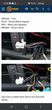

So, I'm finally getting round to this.I have a couple of questions: My eBay stop/start module has a blue wire going into both SSA+ and SSA-. See pic. Does anyone know which one I use and which I get rid of? @Dellmassive
Also, am I splicing the wires into the existing wires/tapping in (blue-brown/black, red-black, brown-brown)? Or do I snip off one end? I couldn't figure that out from Dell's post - probably just me. Thanks in advance!
So Think I've answered my own question. I spotted on the picture in the first post that Dell's unit has the blue wire coming out of SSa+. So I deduce I can clip off the SSA- wire and get rid of that.
Then because I spotted a question about whether you should just cut/splice the wires or de-pin them then solder I think I've answered my other question. The wires are de-pinned and the modules wires are soldered to the original wires (using the correct colour matches) then I re-pin the wires and put it all back together again.
I am a complete beginner to auto-electronics so if anyone could take a moment to confirm this I'd appreciate it. Otherwise I guess I'll hit and hope!
Negative from what I remember when I did mine years ago. If you look carefully at his you will see that it goes to the top connection on the board.
Oh okay! That was a good intervention. Thanks oldiebut goodie . I was going off the picture above in the thread where the blue wire definitely comes from + (see attached) But maybe that picture is from eBay and not from Dell's module??? Dell's board is different to mine anyway. I think he might have the older one. There are different circuits on his board if you look at the pic you posted. But if you reckon it was the SSA- connection then I definitely appreciate the comment. I can't say I feel certain now though!
I used the same module on my VW T-Cross subsequently and that was certainly negative signal. Most VWs should be the same and I am 99.9% certain that the T6 was negative also.
I am sure that above was a generic pic from Ebay from the listing. If you don't specify which vehicle and hence signal polarity when you buy it you get the module with both connections as default. I stated which vehicles mine were for and was sent the correct configuration accordingly.
Again, thanks for the info oldiebut goodie . That makes me feel a bit better. Re: stating which vehicle and polarity when you buy the module; In my case I stated which vehicle I owned but received what I received. Sometimes things don't work out perfectly. I appreciate you sharing your experience. It's most likely helped me from cutting off the wrong wire! If I want to be uber cautious I can leave the other wire on and it all open until I know it works I suppose...
