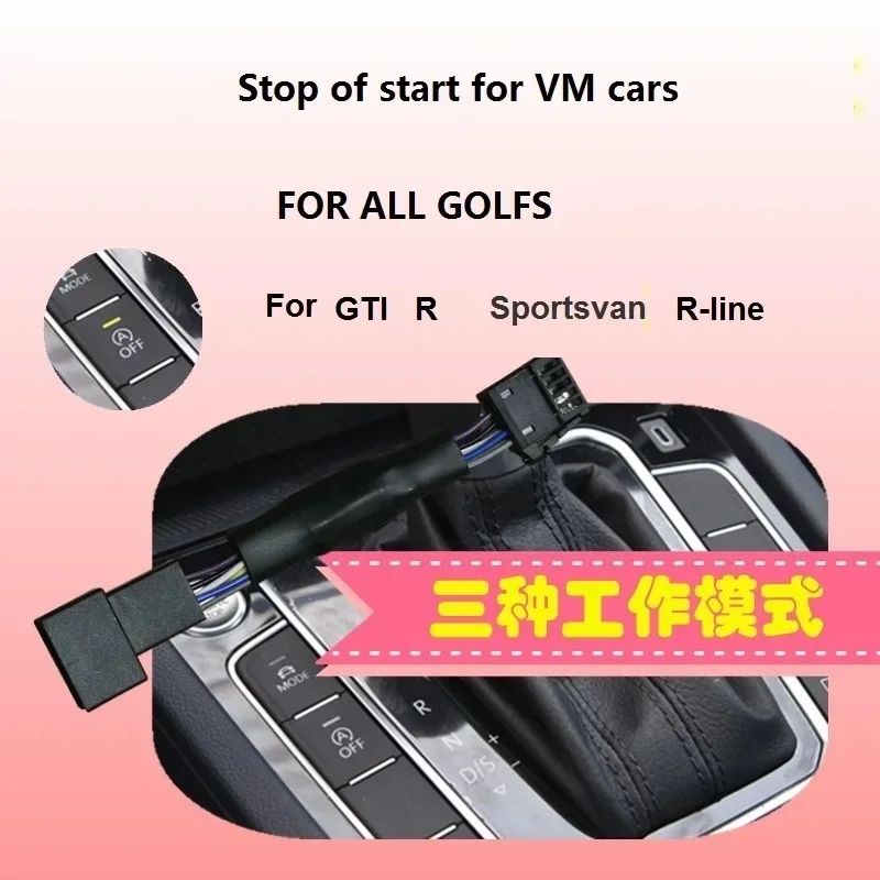

Could you send an example link?Sure for someone who doesn't want to mess with any cabling etc. it's a good solution. Although there are some better modules in aliexpress which are plug and play. You just plug the module between buttons and car cable.
Do you have a link for this trickerySure for someone who doesn't want to mess with any cabling etc. it's a good solution. Although there are some better modules in aliexpress which are plug and play. You just plug the module between buttons and car cable.
