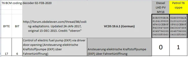

Thanks... that's a petrol engine? Any chance you could also share the coding for 09-Central Electrics (actually the VCDS scan of the module 09)? There is just one spesific bit I'm interested - related to prepressurizing fuel lines before engine startup - presumably differently than for diesels. I'll report back about that...
EDIT: Never mind - it's already in there :oops: :geek:

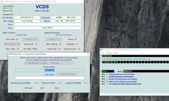

Quickly went down to the garage, and took some screenshots. (VCDS is version 20.4 btw)
Seatbelt: Go to 17 - Instruments, then Coding (just say no when it asks if you want experimental coding), then it's the byte that's in yellow. Just untick the box.
Start-stop: Go to 01 - Engine, click on Adaptation, choose the right channel (activation of Start-stop function).

Excellent. Thank you very much. I believe I already found what I have been looking for - BCM Byte 17 - Bit 6 in T6 with petrol engine. On petrol T6 it is indeed set to "1"- on the right below. On diesel seems to be always "0". Fascinating :grin bounce:
