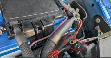

Thanks for that advice. I'll check mine out mateSome vans have a separate wire connected to the battery for monitoring it, and perhaps it has not been reconnected when the battery was changed.
Here is an example: ( without is cobnected stop start will not work)
Thanks for that. I checked mine but no loose wires were present. I took the tape off the wires leading into the battery sensor and this is what lurked beneath it. On closer inspecton it looks like the plastic insulation around the red wire is broken, but not the wire itself.Some vans have a separate wire connected to the battery for monitoring it, and perhaps it has not been reconnected when the battery was changed.
Not as far as I know. I just swapped it over. I did ask a mechanic about that and he said no it shouldn't need to be coded. Could this be the cause of the stop/stat error? And do they have to be coded to the van?Did the new battery need coding to the van?
Possibly, don't really know. Maybe just on newer vans.Not as far as I know. I just swapped it over. I did ask a mechanic about that and he said no it shouldn't need to be coded. Could this be the cause of the stop/stat error? And do they have to be coded to the van?
