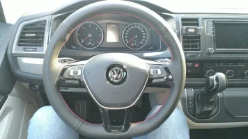

Does anyone have the same button configuration as this wheel but in a golf wheel? R or gtd. with dsg?
I Have a couple of wheels i run with the same setup as yours. GTI one is from a polo and the other is from a passat i think. The main importance is making sure the buttons match what you have and the airbag hooks are the same. Both these wheels were plug and play using the standard wiring loom on the airbag. The passat wheel is away being re-trimmed ATM.
I sourced mine from Europe, both new wheels. There are a lot out the with ACC controls now. These will not work unless you swap the switches and wiring from yours to that wheel, which i have never had to do.
You don’t happen to know the part number for the golf wheel do you? All the ones I find have the acc on. Which do you prefer?

I dont have a golf wheel . AFAIK GTI one is a polo and the other is from a passat as i said . Never looked to see if there are part numbers on them i will look when i swap them again for you . My passat wheel is away at trimmers for a couple of weeks thow . I like them both, just nice to change between the two now and again, just like some do with wheels :whistle:;)

Sorry mate. I meant polo wheel.
I can get the GTI wheels for £800, brand new with airbags. Or Ill have a full custom version as previously mentioned
I have a manual golf r wheel i can supply with correct buttons depending on your set up, it is used but the airbag is new.
