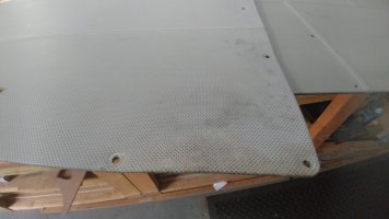

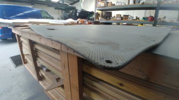

Hi All, here is another example of the effects of the OEM leaky window saga. Shame VW vcan resolve this problem. We've seen leaking windows on vans with less than 100 miles on the clock. :oops:
These Sportline leather door panels are for the bin now unfortunately....
