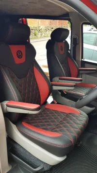

Is there much change in height with these? They look great! Presume you fit the mounts to the original bases? Do you have link to said bases please? Thanks in advanceView attachment 89756

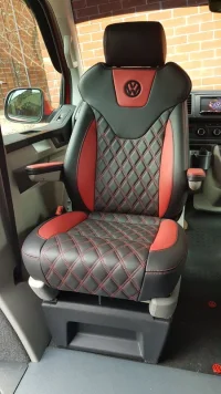

Pic of my Recaro Trendlines in Nappa Black. Bolted using Recaro universal mounts (passenger on a swivel base)
Perfect, sounds simple enough. Any issues with airbag etc? Seems a straightforward mod really and opens up all sorts of recaro seats really using the universal frameThanks, they are great to drive in too, and I think look awesome! The height feels pretty much the same, but I didn’t want to add another inch so the swivel base, hence why only doing it on the passenger side.
The bases were ordered from here: Recaro Seats - VW Bus T6 Direct Fit Sub-frames > GSM SportSeats4u
They bolted to the original seat bases then the Seats direct to them. Was pretty straightforward once I worked out the subframe assembly.
Sounds good, for the relative small cost of some second hand OEM recaros I might trial a set on the universal frame. You'd think that OEM spec trendlines from say and Evo can't differ that much from off the shelf in a recaro store... I'll do some digging on itSo only aftermarket Recaro’s will fit the subframes apparently; so Recaro’s originally from a Car manufacturer’s won’t fit, say like a set from a Golf ect, but other than that loads of options.
Was originally looking for a pair of CS’s but these came up cheap and had just had a full retrim in super high quality Nappa Leather and couldn’t resist.
And no issues with Airbag as mine didn’t have one in the seat. I did prep a resistor but it wasn’t needed.
