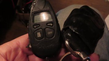

remote battery arrived.. i think it was running low (as amber LED prior to any other feedback), but still not pairing.
VCDS option kept failing 'do to safety reasons', probably low start battery < 12.2v.
I've been pulling the blue cable from the T91 telestart unit, seen lots of people online talking about pulling fuses, but blue cable seems easier.
Pretty sure the relationship between T91-Telestart and the remote is completely separate from Car and/or Webasto heater.
Eugene - I'd happily buy / borrow a spare receiver. Or alternatively I'll send you my remote/receiver.
The reciever and remote only need 12v and ground to pair. Will send a pm
Reactions: mmi
Success finally. I sourced separately the identical fob and receiver, but didn't work, could work out which was broken. Brought replacement as a kit, worked immediately.
I was a bit worried about the sound of EuroFighter taking off from under the car, but it all kicked in well.
Robert - quick question. I like you, don't have the control unit. The fob doesn't appear to do anything other than on/off... can't change timers, confirm cooling Vs heating, switch modes. Is that an expected limitation?
Reactions: mmi
It is because you are doing it on the cheap - you need to use the HTM T100 if you want bells and whistles.
The T91R manual implies you can do most things through a series of button combinations and led responses, but my remote doesn't respond to anything other than on/off. Out of interest do you have the timer unit installed too, along with your fancy remote?
I have installed mine for my Air Top Evo40 air heater. Timers, heat control, ventilation is all controlled by the Telestart or the Multicontrol. Not linked to the VW system whatsoever - I don't know why anyone would only do half a job and leave the heater under the control of VW.
Not all the remotes have full function, I have several Telestarts that are restricted in this way, some only allowing 30 minutes run time, some only allowing on and off. It all depends upon the software loaded on the remote, just because there isn't a logo on it that doesn't mean that a manufacturer hasn't put its own software version on it. It is an absolute minefield trying to marry up separate secondhand items like a remote and a receiver. You must buy the receiver and remote as a matched pair ( and ideally know its origin ) or have a large box of various remotes and receivers to play with.

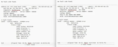

So I bought the complete 40GB FLASHING data archive for VW group. Flashed my faulty screen using ODIS engineering. That didn't help.
I then bought a second new (used) screen from Poland. plugged it in ran a scan and then tried to clear errors using VCDS. new screen also has the same EPROM error code. I can't be so unlucky to buy 2 duff screens, what else can I try?
Here are the before and after scans comparing the 2 screens.
I am totally stumped, I really want to clear this error it's driving me nuts.
To add the screen to the vehicle I just added it to the list using VCDS.
I then Flashed the Heater in ODIS E.
learnt the remote with VCDS.
I then ran VCDS with engine on to do a scan and check everything.
I cleared each code individually as VCDS doesn't seem to clear codes on my t6 via the clear all button.
The EPROM error immediately comes back and won't clear.

what I find weird is that both screens have the millage completely wrong. its like the connection between car and screen isn't setup correctly or is broken.
I checked the resistance down both Bus lines to the connectors under the seat it's almost nothing. The voltage and earth to the screen is good.
I could try using the other flash file I have for the screen, I can't imagine that would help.
7E5919037__0165.sgo
both screens have the 7E5919037__0200.sgo
I am really out of ideas.

I put the first screen back in the car and that also works it definitely didn't before flashing.
The eprom error is still there. I would love to clear it myself so I can call this job done and move onto the next project.
Any suggestions would be appreciated.
I'm sat in the car did another scan .
I swopped the roof module back to the first one.
here's comparison between 2 weeks
the millage time stamp, and fault counter appears unchanged.
