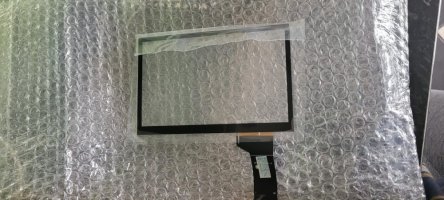

I had this problem on my California.
Since i didn't find much detail online on how to fix the touchscreen, i made some video notes here:
Like all things, It's not that complicated once you know how.
The touch sensor costs about €15 shipped from China in about a month.
TDO-WVGA0633F00039 or TDO-WVGA0633F00045. (They are both the same part i believe.)
I thought i was going to have to try and un-stick the broken touch sensor from the LCD screen. They are glued together.
The thing that made the job much easier than i thought it was going to be is finding out how thin the touch sensor is.
But when the new sensor arrived, it was only about ~1mm thick so i just placed it over the top of the broken one without removing the old one.
The main head unit case is forgiving enough to take up the extra thickness.
Hope this helps someone.

Thanks Dunk,
The digitizer is selling for £25.13 on ebay and the seller is in London. Your vid has convinced me to do it the same way so will give it a go next week. Thanks for the vid and guide, really appreciated.

Finally got around to fitting the new touchscreen as per Dunk's instructions and it works perfectly now. Thanks alot Dunk; much appreciated and you saved me around £300!
For anyone thinking of replacing the digitiser, your replacement will have double sided tape around the edge, the existing one is fully bonded to the LCD screen. You can't remove it and trying to do so will break the LCD. I know :cry: s o do as @dunk says and lay the new one over the top of the old one.
