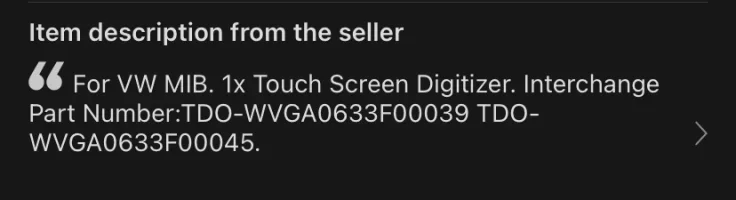

Yeah im up for it, are we confident that the above link is the correct unit ?Its just small torx bits you need something like a T10 & T6 don't quote me on exact sizes thou as I didnt look! I've ordered the digitizer its from china so can take up to 6 weeks to be delivered I will have a go at fitting and post the results when I get it
Where did you get the digitiser from Pauly? Was it a composition or discovery unit?I swapped the display on mine as it developed the ghost touch jitters and became unusable and I still have my old faulty one in the garage, may see if I can fix it up for someone
