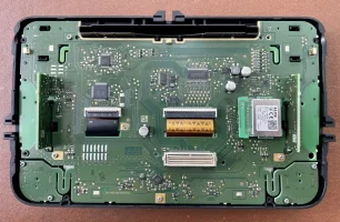

How do I get the front fascia off from the pcb? Seems wedged and no screws I can see...
There are the two SD card holders that come out you will see to plastic clips on the side, and if you have a little plastic tool to just separate the connectors on these.
Also use a little plastic tool to pry up the corners where the external round control buttons are and they should pop off from the other side.
Other thing I did was put electrical tape on the inside of the metal case where the digitiser connector comes out. I did this as the new one didn't seem to have as much insulation as the old one. Maybe overkill
