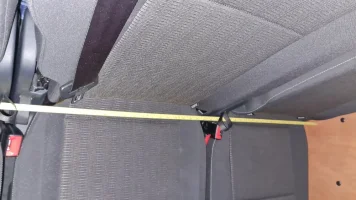

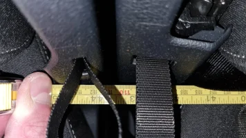

Hi everyone, those that have fitted the 3 + 1s could you possibly stick a tape measure against them and measure from the left hand sliding door to the far right of the middle seat? I want to see if I can fit extra seating in the camper and it hinges on being able to keep the existing units.
Thanks
Al
Thanks Foggy, that’s perfect for now just to see if the concept works. Think it will probably clash with the fridge but only one way to find out.I guess there'll be a bit of variation in the measurement depending on how accurate the installation and what sliding door furniture is attached.
I get 1150mm from the inside of the NS slider (with 6mm ply panel) to the far side of the plastic mechanism cover on the single middle seat. Photo demonstrates it better....

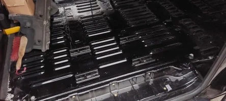

Didn’t need to remove fuel tank in it’s entirety.
I proped up the filler end on a plank of wood and blocks , then used a Jack to lower the tank from the middle , I managed to get all brackets secured with tank only lowered at one end ,

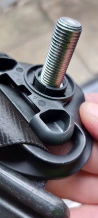

Hi guys, does anyone know where to get the seatbelt guides on there own?
Thanks
Hi foggy.Guides as in the black plastic part that clip into the inertia reel covers?
@foggy3061 i recently bought a 2nd row kit from a guy based in Coventry (van leisure) and it didn’t come with any guides. The piece that clips or bolts onto the ply lining bit.
I can’t be bothered to go back to the guy as I had some hassle with him.
Looks like I will be calling TPS on Monday.
I ended up with a shuttle kitFair enough. There are lots of sellers pedalling Shuttle seatbelts as Kombi belts - so people end up with no guides and top mounts that don't swivel.
Yes no problemIf you find out what the part number is would you please share it on here as I've been through the box of parts I have and I can't find one.
Cheers
Looks like it could be: 703 857 747 01CIf you find out what the part number is would you please share it on here as I've been through the box of parts I have and I can't find one.
Cheers
MK4 golf, some polo and lupo all have the suitable rear top mount you're after.I ended up with a shuttle kit
I will be changing the top mounts to golf ones. Just need the guides.
Thanks for your help @foggy3061MK4 golf, some polo and lupo all have the suitable rear top mount you're after.
Luckily they can be threaded over the buckle and onto the belt. I've done a few for friends - who were also sold Shuttle belts as Kombi belts.
