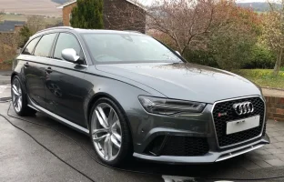

Ace mate. Didn’t realise you’d gone for the 2.0tfsi great shout! I couldn’t afford the fuel for that! After owning an s3 with the same engine, I know how much that guzzled!! So couldn’t imagine the van!
Giving me plenty of guidance for when I do my electrics.
I'm used to bad MPG... Coming from this I could only have the TSI..
