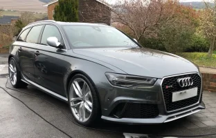

You sound a bit like me.. I sold this to buy a van.. Not regretting it yet.. ;)

Brilliant thread, got my first T6 in September, moved away from the fast Audi’s (not quite as fast as the rs6 tho)... we’re moving at the same sort of speed, funds holding me back unfortunately as I am currently back being an apprentice. Got the electrics lined up, so I’ll be following your thread. Happy with the door seals from the forum?? Have my eye on the camera too.. scary to be cutting into the van tho! Ha
