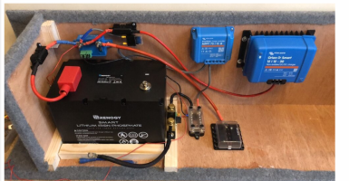

next option is to build your own mobile battery box,
and add a dc-dc charger to the van for remote charging off the engine. . .
then add in a DC-DC to the van:
with quick disconnect cables so that you can just plug it into the van when needed . . . . . .
