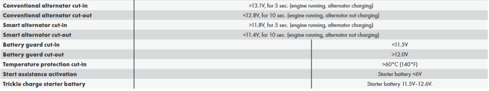

So I double checked the CTEK manual and it looks like it's using voltage sensing for conventional alternators and ignition signal for smart alternators - which type do you have @Brian1852
Edited to add: See later post, looks like the CTEK is doing voltage sensing in both cases, the ignition signal just moves the voltage thresholds wider
One thing I noted which I had missed in previous reads is it does have a starter trickle charge capability, so for storing if you have fitted the charger to EHU just leaving the van on EHU should keep both batteries topped up. If you have things like power doors that might not be enough to keep the starter fully charged while camping though.

Useful knowledge - that's really not clear from the manual descriptions of the two modes. I do really like the CTEK kit, but the manuals can be frustratingly brief and unclear at times.
The description of the function, along with the need to connect a cable to ignition sense for smart alternators, suggests one behaviour
The details of the voltage cut ins buried at the end suggest very different behaviours
That would seem to suggest it's not really an ignition interlock as other chargers use, more an option switch like the battery select cable.
So even with the ignition sense connected with ignition off the CTEK will respond using the conventional alternator cut in voltage.
I've also never noted the significance of the "Start assistance activation" line before - which while useful as a manual option I'd worry a bit about as an automatic option as if the van is stored and a failing starter battery drops that will cut in... Quite what that behaviour is doesn't seem to be listed anywhere in the manual...
