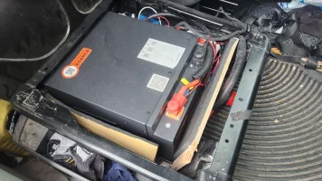

that means that in a T6 - you need to find somewhere to place them.
the VW Assist guy had his bolted down in the rear racking. . .
ultimatly ill have this built into the rear cupbards when i get the bus converted,
or
fitted under the RIB/rock n role seats in the rear. . . .
in the mean time ill have to get this setup as a mobile unit that can fitted and removed as required.

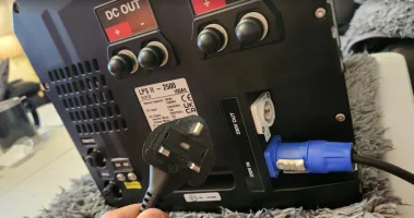

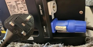

we started with the 240c mains charging. . .
it comes with the mains lead and the fancy locking plug. .
notice how the plugs are recessed into the unit so it be pushed back to a wall flat - a very nice design touch . . .
switching the mains on you get a full rate charge, about 700-800w into the unit . .
that was verified with a Watt meter . . .

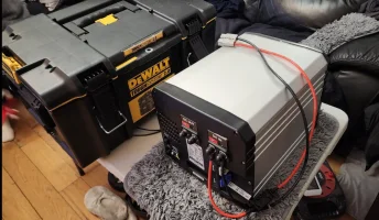

so making up a quick fused 50A Anderson connector.,
and grabbing one of my 100ah lifepo4 battery boxes - that has 50A Anderson IN/OUT fitted.
i connected the two together. .
the idea being, can i charge it from a battery box.
at first nothing happened. . . .
then after a quick look at the install guide i noticed that the unit needs a BCM engine run feed or a +12V IGN feed . . . connected to C1 terminal.
that aklows the unit to start charging . . so a quick jumper wire connected and off we go. .
the unit quickly ramped up to 45A charging power from my battery box. . .
this is the main reason the EcoFlow Delta2 and other portable boxes have issues being fitted in the van. . slow 8A charge speed.
well not with the Clayton - Bang 45A charging speed, just like that.
infact you can add a super charger that doubles the charge speed to 90A !!!!!!! (a second 50A fused connection to the starter battery is needed, effectivly its a double dc-dc charger setup ) - not that is FAST !!
keeping an eye on the cable and connections for heat build up . . as 45A is a lot of power,
i come across the internal monitoring screen for temps and cell voltages . .
and also come across the DC IN current limiter. . . SWEET !!!!
so you can limit the DC IN charge current from 10-45A, very nice. . .
so i dropped to 10A charge rate and went from there.
i could that the 4AWG cable and Anderson didn't get warm (in free air) - FROM 10-30A.
then started to get warm at 40-45A,... but didn't get hot.
this shows the POWEROAD APP for the BMS of the battery box that was charging the clayton . .

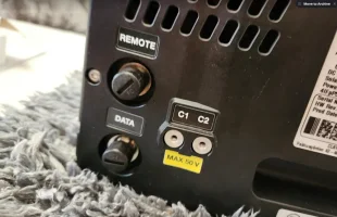

the SOLAR input used the C2 terminal.
i bridged a jumper wire over to test the input from the battery feed, and it worked as expected. . .
so just need to wait for some sun to connect some panels up to it.
the PV input shows 400W, with a VOC max of 50V - nice touch Clayton.

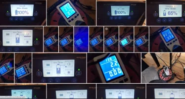

i charged to 100% SoC,
then set the AC ON, and turned off the AC low power mode. . .
oh yeh, did i mention that?
the unit has a LOW POWER mode, where you set a low wattage point, say 20W and a timer, say 60min - defaults.
then when the wattage drops lower than 20w for 60mins, the unit switches off.
once its off . . . its off and you have to manually switch it back on.. .
its not like the Victron inverters that monitor the load and will restart is a load above the set point is detected.
back to the test. . . charged to 100%, switch AC ON. (29/8pm)
an hour later we show: 97% (29/9pm)
the following morning we was 65% (30/8am)
so im thinking quick maths,
from 8pm to 8am is about 12hrs,
and it lost 35% SoC self consumption with the AC inverter ON.
Not bad methinks. . . . seeing as my Bluetti AC1200 used 25% SoC per day just being switch on without the AC on.
not sure how that compairs with the Ecoflow Delat 2? - maybe someone can try the same test? (100% Soc, then AC ON for 12hrs and report the SoC)
so loosing 35% SoC per 12hrs could mean 70% per 24hrs? - this will ovbs need testing.

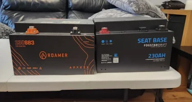

im planning on connecting up a ROAMER 230ah seat base battery under the drivers seat in the BUS and connect to the DC IN of the LPS.
this will give the Clayton 100ah + 230Ah = 330ah worth of off grid power to play with.
effective adding 230% more battery capacity.

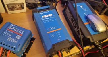

i also show a 12vdc charger, that will be used to charge the 230ah seat base battery . .
ill most likely fit one of my Victron IP65 chargers . . .

Those AC locking plugs are Powercon connectors, very common in the theatre lighting and events industry. They are very robust and have a locking action and good for 20amp and have zero exposed conductors in either plug or socket. They're about the same size as the common IEC ("Kettle") connectors but better in every way (IEC are 10amp and shake loose as soon as you can't get to them) the only thing they lack is waterproofing otherwise they'd replace the standard 16A Commando type connections.
Clayton are also correctly using the Type A/Blue variant for power input and Type B/Grey for power output. This means there is no chance of them being plugged in the wrong way around as you try and connect it back in the dark of a cupboard :thumbsup:
If you look at the connectors a Type A is the mirror image of a Type B - a very neat way of using the same design and operating principle to have two deliberately incompatible types for safety.

Pics tricky as it's in the 'b*****d' cupboard that requires the seat sliding as far as poss back or forwards to get into it...might try tomorrow in daylight as curious what's in the cupboard as really don't go in there often!
Has a fitted double induction hob permanently plugged into the front, sockets 240v and 12v run of it's rear supplies.
Nespresso coffee machine works a dream, but Dyson hairdryers don't like it for some reason despite being rated low enough....spoke to Clayton about it who reckon they must have a strange electronic start with a spike and the Clayton doesn't like it (nothing trips or blows)...very odd, but hardly a game changer, just have a van hairdryer!

Maybe I am being simple, but rather than the seatbase extender battery requiring a further connection to the vehicle alternator and connection into the Clayton's DC in, couldn't you use the seatbase as the 'main' battery, running your 12v kit off that, and have a simpler mains charger to the seatbase battery from the Clayton?
Granted, you'd limit the charge rate of the seatbase and would only want the Clayton-seatbase charger running when the Clayton is charging (from the vehicle running or EHU), but that would be a simpler extended power bank? I'm sure an ignition/EHU linked relay for switching a charger would be a piece of cake for you to mock up :)
i have them on some of my PA speakers as well. a very good connector as you say.
CLAYTON list them as AC Neutrik connectors.

Yep they're made by Neutrik but your speaker ones may will be Speakon not Powercon, Speakon being the 4 terminal low voltage speaker connector. They share some very common design principles and it's often said that Neutrik developed Powercon because they were concerned when some people started to use Speakon as a mains connector (which it technically could do but the consequences of plugging mains into an amplifier output would be a disaster)
Any time you need an event or audio connector but the Neutrik one. They're expensive but they are a joy to assemble and never let you down.
