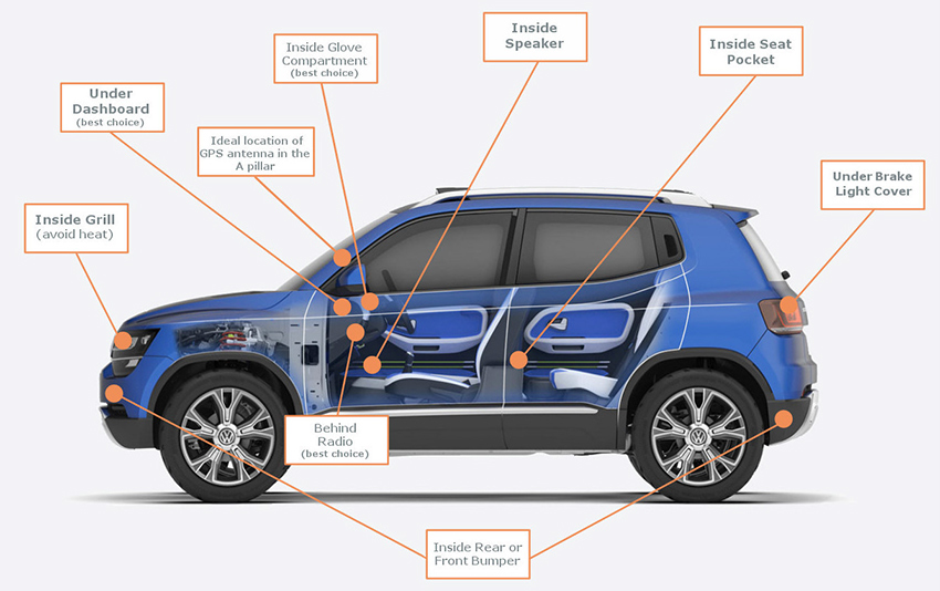

Are you fitting it to the van? Diesel or Petrol? Are you going to make use of the cut off / on feature? You'll need to think about which circuit you are going to use for that and where you are going to mount the relay in the van (it needs to be somewhere where it can see the sky to get GPS reception, under plastic is OK but no metal between it and the satellites.

The reason it shows as moving may be due to satellite movement, ie as the unit sees GPS satellites come in and out of view it updates its location with whatever is available, more satellites seen = more accurate positioning, this is why its a good idea not to set the geofencing or move limits to too small an area, positioning errors can 'move' the van outside of its fence.

It may need to be mounted in a different location depending on how many sats it gets. See how it goes.
