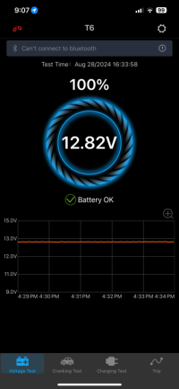

A shunt is much, much more accurate as it measures the actual power going in and out of the battery to calculate the percentage left. The BM2 you have just makes a guess based on voltage at the time which will vary depending on draw or charge. They are almost pointless for a lifepo4 battery. The Victron Smart 500A shunt is good and works via an app (no screen).

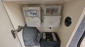

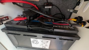

I have a Sterling BB1230 Battery to Battery charger with a Renogy 1000W inverter (the inverter is just for Ebike battery charging and is rarely used as I normally use EHU). No solar, but I may add sometime in the future (been saying that for the last 5 years…) Heating and cooking done in the van with a Wallas XC Duo.
Any opinions on the above batteries? I think they're all similar spec with a Sterling having the largest capacity. I like the idea of good support, so Roamer, Sterling and possibly Fogstar. I like the idea of matching the Sterling B to B charger with a Sterling battery. I like the idea of the increased capacity of the Sterling, but not sure if it's really necessary as I normally use EHU. Any suggestions or comments appreciated.
I can't locate an isolator from the leisure battery, is there an order for disconnecting and reconnecting a new battery? Negative first, followed by positive?

You will need to change the black CBE mains charger as it doesn’t have a lithium profile (unless it’s a different model from the one I’m familiar with). That should be fairly easy as you can tap into the existing cables for it. I’m assuming the installer has also correctly disabled or bypassed the charger relay in the CBE DS300 box when the Sterling was installed? That will either be the R37 resistor snipped (bottom left) or switched off (some versions have a switch) or nothing connected to the B1 positive connector (bottom right).

The eco worthy doesn't come with a BMS App.
So be cautious as there is no way of determining it's state of charge.
Unless you add an additional shunt.... Which then makes it not as cheap.
