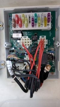

View attachment 265022View attachment 265023

Can you post a pic with the cover off the DS300 to see if that’s been sorted?

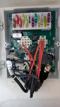

Well, something is connected to the B1 post so they have not bypassed the charger relay by the look of it. Can you get a pic of the resistor R37 down in the extreme bottom left to see if that’s been cut? If not, depending what’s attached to B1, the relay charger will also be charging the leisure battery. Looks like this:
Also, the positive cabling is rather odd depending on what you have in the van. The majority goes to the right hand plug whereas I’d expect to see more go to the left. The right hand plug is for fridge, step, solar and gas. The (poorly written) instruction manual for the DS300 is available here. There is also an instruction sheet on adding a DC-DC charger to the system here. I didn’t follow this as I wanted to keep the box intact in case I revert the van back to sell in the future, or remove the box and sell it. Instead I removed the engine start signal wire and have nothing connected to B1 so the charge relay doesn’t trigger and even if it did the starter battery isn’t connected to supply power from the alternator. The only downside is you lose the starter battery indicator on the control panel but that’s total crap anyhow.

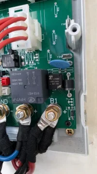

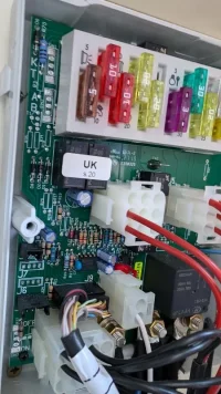

View attachment 265133View attachment 265134

The R37 resistor looks intact and something is connected to the B1 terminal so I’d want to be sure the relay isn’t also providing a charge. Hiwever, there is no engine running wire connected so that may well stop it charging depending how one reads the rubbish CBE instructions. If that’s the case then the other instructions I linked about adding a DC-DC seem pointless - who knows! I’m also intrigued why there are 2 connections to the B1 terminal as there should only be the one from the starter battery.

Cutting the R37 resistor will disable the split charge relay thats built into the CBE unit. You would do this to prevent backfeeding from the Sterling DCDC charger while driving (it's like opening the front door while the back door is open). You would do this regardless of which leisure battery being used, its not a Roamer/Fogstar/Sterling thing. Regarding which is more suitable, thats obviously a personal choice. I'll just highlight a couple of extra features on the Roamer SMART4 that makes it a little bit better than others on the market...
