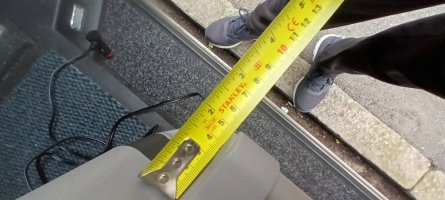

@TallPaul_S length including handles 69cm without rear handle 65cm
Ahhh... It's got a handle on both ends. The pictures don't show that! So presuming the handles are the same size, then the actual body is 61cm, correct?
Mine will be going into a drawer so I'll probably remove the rear handle, leaving front on but with it protuding from the drawer to act as the drawer handle and to be able to see the display. Means I can make the drawer a few cm smaller which is very handy. Cheers!

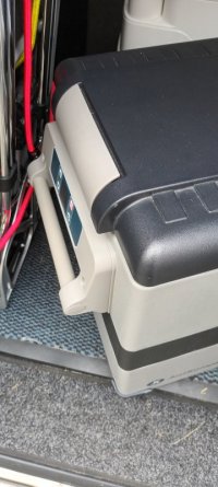

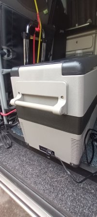

@TallPaul_S I will post some pictures of the rear later but also the power plug is on the rear and some ventilation that curves around from the side so taking the rear handle off may not be a good idea
@TallPaul_S the rear handle sticks out 53mm from the main body and the power plug 35mm so by taking the handle off your only saving 18mm plus if your cutting a hole for the handle the lift up lid protrudes as well if you need anymore information let me know20230724_092420.jpg20230724_092447.jpg20230724_092534.jpg
@Bargy62 that's brilliant, thanks a lot!!
Looking at that, with the power socket placement and the more importantly, vent placement, it's just going to be too tight to fit in. I'm going to look at the alternative route of a non portable fridge unit instead, something like a dometic/alpicool etc CRX50, with a 240v adapter so it'll run off hookup when available or 12v as standard.
