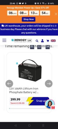

Right, I think I have worked it out now:
Renogy 200w flexible solar panel
Renogu 12V 100Ah Smart Lithium Iron Phosphate Battery w/ Self-Heating Function
Renogy 50A 12V DC to DC In Vehicle Battery Charger W/ MPPT Solar Lithium + Bluetooth module.
12v 12 way fuse box and all cables etc.
I am going to add the EHU soon after.
