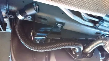

Unsure why it would be this way?.
Mine is fitted with an exhaust etc and is up and running, I have just got to connect the inlet ducting together.
ok thanks, that reassures me. No i dont see why it would be any different.. i have found pics on another forum of the underbelly of a cali without the protection & its the same thing..

Not as yet but yet to connect the front duct(due to time).
just had a chat to Webasto dealer and its to do wit hthe fact that the webasto & eber silencers are not gas tight, therefore with underbody protection the CO could build up and not escape.. potentially going into the van.. o_O
