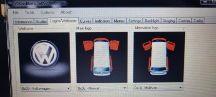

By setting alternative graphics to T6 and main to T5 (or vice versa) in Instrument Cluster EEPROM the switch between these two sets can be performed by tweaking the coding in address 17.Thanks Laszlo!
I should have tried your suggestion much earlier.
Now I need to swap my graphics and I must have custom WHITE/RED![]()
Yes, but only can use oneBy setting alternative graphics to T6 and main to T5 (or vice versa) in Instrument Cluster EEPROM the switch between these two sets can be performed by tweaking the coding in address 17.
What Vagtacho are you using @Robert?
Genuine "full version Vagtacho" from Original VagtachoWhat Vagtacho are you using @Robert?
