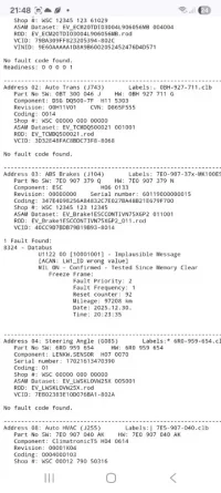

Issue now is with traction light staying on please any help would be highly appreciated as my brain is dead nw please find attached vcds scan

What fault codes are you now getting that is causing the ABS/traction light to be on?

It's defo that what you said as I had same code in pdc and parking sensors where not working I coded out trailer hitch and fault cleared and parking sensors started working

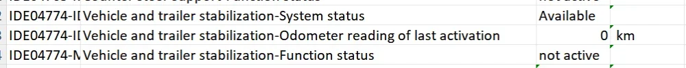

No traction light is still on with the fault above in picture just to ad i changed byte 15 on abs it was d3 which means vehicle has tpms i changed it to e6 which got rid of tpms light flashing but u code remains alongside traction light

If you do a Blockmap log dump of the 03 module, does it give any information on the trailer. eg
ETC

Hello guys sorry for the delay firstly I want to thank everyone especially mmi the legend you put us on the right track so we performed basic settings on the steering angle sensor through abs module and wallaaa lights gone faults cleared and acc working as it should.
Puzzled though why there was no steering angle fault but had databus missing message anyhow im over the moon once again thank you all.
