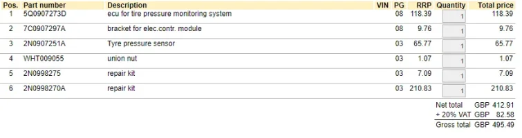

You'd need to find out what the part number of your sensors are. PM @Pauly with your VIN number and he'll be able to tell you.

and the (ludicrous) prices to go with them, the strange thing here is No6 is a complete unit but it looks like if you buy 3 & 4 they would make a complete unit at a significantly lower price, unless 6 is for a set of 4 which isnt clear ??
