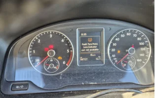

2015 VW T5.1 with Indirect TPMS system that was working fine before
  • In December car had low battery as it was not used in winter and from that time TPMS light came ON
  • All Tyres have correct pressure but the error on Dash comes ON right after turning key stating FAULT: TYRE LOSS INDICATOR CURRENTLY NOT AVAIALBLE and TPMS symbol keeps flashing
  • It can's be reset with new tyre pressure and says TYRE PRESSUER NOT STORED

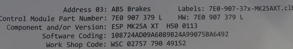

I think I would try first to code in different Long Coding code. Can anyone share long coding code from ABS unit that has indirect TPMS ? If that will not work I will try to get ABS unit and adapt to my VAN and hopefully that will help. Can you check your Long Coding against mine ? (2nd picture).

My long code Caravelle 2015 indirect TPMS
You can't just paste someone else's ABS long coding onto your van. The VIN number is encoded as part of the long coding so you'd have to know which bytes were for this and which are for programming.
