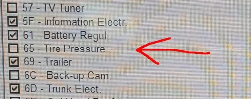

The BCM (PQ25 Max4 7E0937090) needs to be minimum hardware version H81 to have address 65 (Tire Pressure) on CAN GW installation list.:)
But if yours is lower then not to worry cause BCM is very easy to be replaced and second hand units can be bought for approximately £53=€60;)
Seems to be MY17 onwards then... :)
