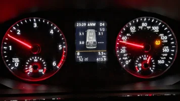

Must have been ok because it worked. Got a scare because it was not showing any values but I drove around a bit and the numbers appeared.
I still have the orange tyre warning icon on the cluster though. Couldnt get to the screen with explanation. Should I just clear the faults now ? Manual doesn't mention it.

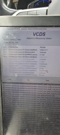

Edit: Autoscan shows faults in almost every controller. I checked 65 (tyre pressure) which was showing red - not registered but no faults there. Checked can controller and it has a fault which doesn't clear - something about additional installations detected.
I'll attach the scan later
After clearing all faults only three places are left red.
Attaching scans
So turns out the kit's firmware was outdated. They provided the update and the error is gone. All working properly.
Attaching scans
You just need to TICK the box for address 65 in the INSTALLATION LIST of your module 19 CAN-GATEWAY.

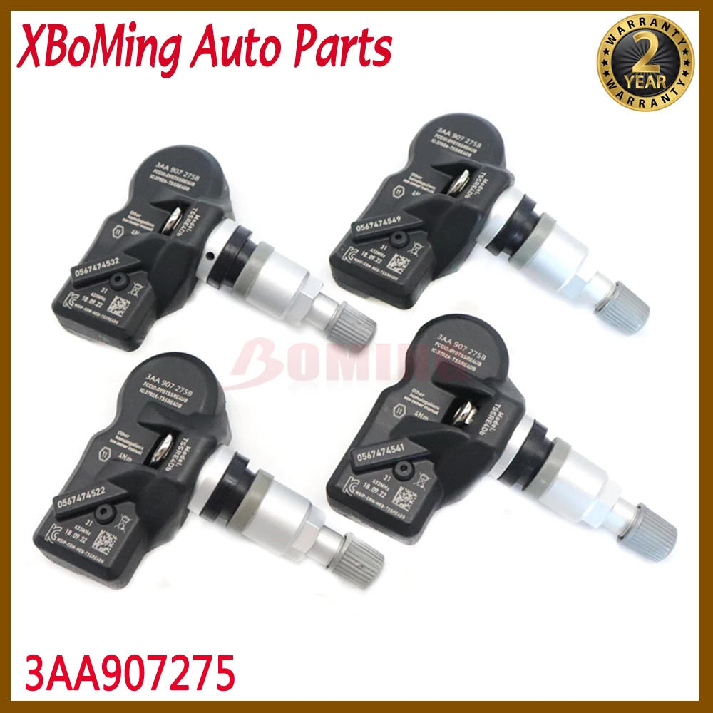

Found these sensors 3AA907275B
Not that I would need them but I think it is a time to have some spares in the back pocket.
Price was temping and quality seems to be promising.
Manufacuting date is quite recent -> 8th of December 2023.
Additionally there are no spelling errors imprinted on this lot :D :p
