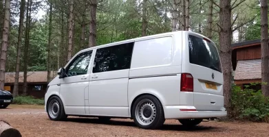

Thanks @Tourershine and @T6180. Good to know yours are all fine. Mine were done by Duchy too and went on today in the end. New set of original T6 bolts required first as obviously the alloys it came with have different bolts. Other than that no issues and the indepent tire place had no issues fitting them.
Look and drive brilliantly - happy days!
To add to all of this for info, if anyone is putting banded steels on a California, don't go for 9.5 rear as they will foul the sliding door card. Thankfully buying from someone like Duchy meant he's happy to have the 9.5 rear returned and make me an 8.5 front 9 rear setup for the cost of deliveries.
